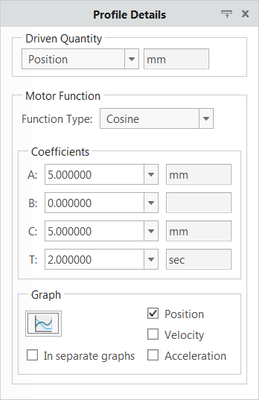

I'm fairly certain that there isn't a general algorithm to find the motion envelope for a mechanism - so you have to take the "brute-force" approach of iterating through the valid combinations of joint settings, then merging all cases.  I could see setting up a clever user-defined motion profile for your 3 servos in order to get this 3-level iteration loop in Creo Mechanism.
Have you tried assigning a motor to each of your actuators, set to drive harmonic motion (maybe at different frequencies?)
I'm thinking with enough runtime, you could get a pretty close answer.

This is a great use case for the Behavioral Modeling Extension (BMX). BMX coupled with mechanism should be able to do what you are seeking to do. You can run a feasibility/optimization study and by setting the goal of maximizing the volume of the motion envelope while varying the inputs on your actuators, the process will be automated.
Without the use of BMX you will need to figure out how to bound the solution space and use mechanism functionality to iterate to a solution.
