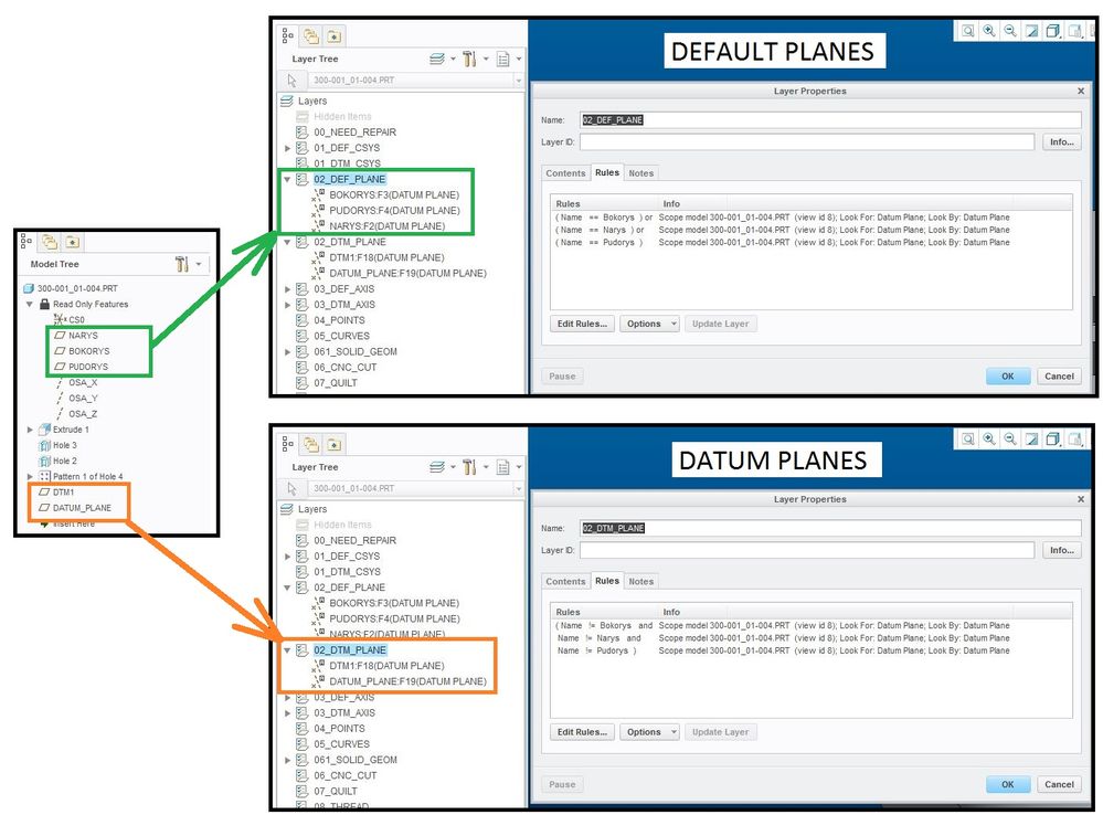

This is a cry for help (read: rant) regarding layer rules. I have been trying for days now to get them to work but they seem extremely bugged and inconsistent to me. Some rules don't seem to work at all.
Sometimes rules for one type of feature work while the same rules applied to another type of feature don't work.
Let me show you an example:
I have a layer 02_DEF_PLANES for default datum planes, including them by name. I have another layer 05_PLANES for all other datum planes, excluding the default datum planes by name. This one works.

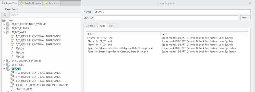

I also have a layer 03_DEF_AXES for default datum axes, including them by name. I have another layer 06_AXES for all other datum axes, excluding the default datum axes by name. This one just ignores the naming rules and puts the A_X, A_Y and A_Z axes from the external inheritance on the 06_AXES layer. Note that these axes are NOT on this layer in the inherited part.
What is going on here?

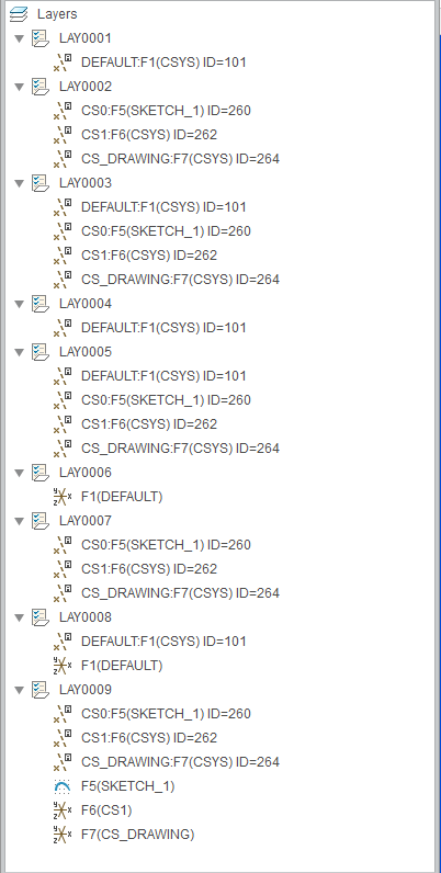

Not exactly, that's why I'm wondering what is being searched by on your 01 and 04 layers. Here is an example of what I'm referring to and see if they make sense to you. I'll include how I interpret what I'm seeing.
  1. LAY0001 searches for a coordinate system with Look for: Coordinate System, Look By: Coordinate System, with Attribute Name: *DEFAULT. Datum DEFAULT is placed on layer.
  2. LAY0002 searches for a coordinate system with Look for: Coordinate System, Look By: Coordinate System, with Status: Layer: Not Included: LAY0001. Datum DEFAULT isn't placed on the layer since it's included on LAY0001.
  3. LAY0003 searches for a coordinate system with Look for: Coordinate System, Look By: Feature, with Status: Layer: Not Included: LAY0001. Datum DEFAULT is placed on the layer since LAY0001 doesn't have a feature on it named DEFAULT.
  4. LAY0004 searches for a coordinate system with Look for: Coordinate System, Look By: Feature, with Attribute Name: *DEFAULT. Datum DEFAULT is placed on layer
  5. LAY0005 searches for a coordinate system with Look for: Coordinate System, Look By: Feature, with Status: Layer: Not Included: LAY0004. Datum DEFAULT is placed on the layer since LAY0004 doesn't have a feature on it named DEFAULT.
  6. LAY0006 searches for a coordinate system with Look for: Feature, Look By: Coordinate System, with Attribute Name: *DEFAULT. Feature DEFAULT is placed on layer.
  7. LAY0007 searches for a coordinate system with Look for: Coordinate System, Look By: Feature, with Status: Layer: Not Included: LAY0006. Datum DEFAULT isn't placed on the layer since it is part of the Feature DEFAULT definition.
  8. LAY0008 and LAY0009 used OR rule definitions to get items on layers.
In order to make sense of the pics of the layer definitions shown I'd need to see the rules for layers 01 and 04
and what ends up on them.

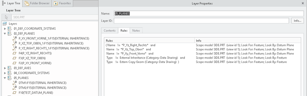

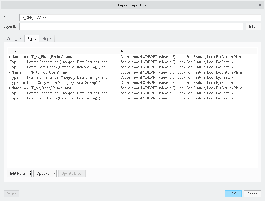

I'm still struggling with those layer rules. I'm trying to get coordinate features and coordinate entities to show up on one layer, but not the entities when the feature itself is already on the layer. So a CS feature should not have the CS entity on the layer as well. A sketch feature which contains a CS should not be on the layer, but the CS entity should. While I was working on this I noticed some weird behaviour in the and/or statements.
The first 3 images show the exact same rules as the last 3 images. Only the order is changed and the and/or statements are changed to match the order. These should give the exact same result but the preview shows the don't. Am I missing something or is it a bug?

They won't give the same results because in one instance you are looking for a feature and in the other you are looking for an entity that is part of a feature. Try
Look for: Csys
Look by: Feature
               Attributes: Type: Sketch
Look for: 3D Curve
Look by: Feature

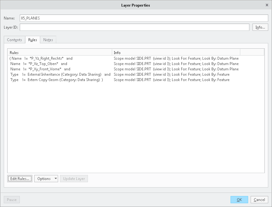

I f you compare each of the 3 rules side by side you can see that both rule sets are identical. At least in my opinion. The difference is only the order: (A and B) or (C) vs. (C) or (A and B).
Kevin
(To:Wouter)
It would also be helpful to see what the rule dialogs are for your 01 and 04 layers. What I'm referring to is when you look for a coordinate system and look by coordinate system you get different results than if you look for a feature and look by coordinate system. So it's not just the rules you need to look at but you need to look at what you are looking for and looking by. The results will be different depending on the combinations chosen. There might be a conflict there that is giving you something different than you're expecting.
Wouter
(To:Kevin)
The rule dialogs are in the screenshots to show exactly what you described. The results don't make sense to me.

Wouter
(To:Kevin)
@@kevin
Thank you very much for your elaborate answer! It really helped me understand the rules better
In particular LAY0001 and LAY0003, where the CS DEFAULT -is- placed on LAY0003, because LAY0001 has the CS on it found by look by CS where for LAY0003 it is placed on the layer because it is found by look by feature.
I expected the CS DEFAULT -not- to be placed on LAY0003 because the CS DEFAULT is already on LAY0001.
I din't know that when referencing (items on) other layers Creo also takes into account the rules by which an item has been placed on a referenced layer, not just the fact that the item exists on a layer (ignoring by which rule it got on that layer).
I find this very confusing and it makes understanding layers more difficult, but I think it might just widen the possibilities to precisely define what is placed on a layer.
