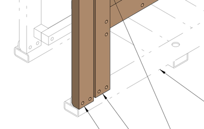

This isn't directly possible, but I found a work around... Overlay two identical views.
Start by creating a view with the desired view style, (say no-hidden). Then duplicate your sheets. On the duplicated sheet with the duplicated view, change the view settings to the other desired style (say shaded).
Then use the component display command to blank any components as needed. (typically you'd only need to blank components on the shaded view that you want to show as wire-frame).
Then move the duplicated view back to the original sheet where it should exactly overlay the original view. Attached is a zoomed in sample of such a drawing.
A shaded View overlaid on a view a no hidden view with the phantomOpque styleA shaded View overlaid on a view a no hidden view with the phantomOpque style

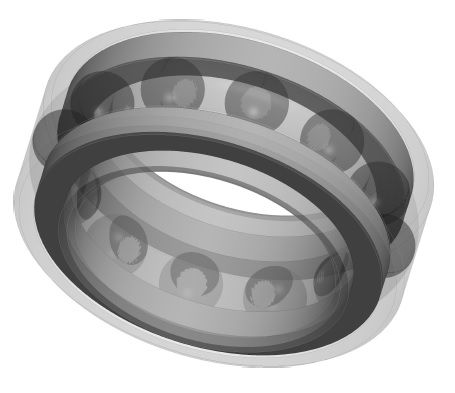

Hmmmmm, not a perfect solution, but create a quick assembly as a copy of the real one where you define colors where some are more transparent than others.  In your dwg, add it as another model, then add a shaded view of it.  Not perfect, but...
Or, probably a better solution, is you could create materials that are transparent, make the assy a family table, for dwg views have an instance that is with different transparent materials for your dwg.  This is the method I'd use to keep it all in one assy.
Here's a pic from a PDF of a dwg I made to test.
