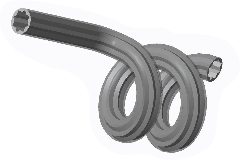

I need some help regarding a modell i made. First I made a simple tube, then i created spiral cuts on the surface inside, with parameteres, so i can change the number of the spirals, the number of the turns of the spirals and of course the shape of spiral cuts. Now i would like to make from the straight tube also a spiral, a spiral tube. So i would like to have a spiral tube and on the surfafce inside the spiral cuts as i wrote. but the problem is that i can not make it with different number of turns. It works only if the spiral tube and the spiral cuts inside have the same number of turns. Could someone help? Is it  possible somehow for example "to turn" a straight tube?
On the pictures you can see my problem better. The two tubes i would like to "unite". Please Help!! Thanks in advance!

Hi, see if this helps.
I control the spining of the tube and its cut using 2 separate sweeps and the number of turns can vary independently.

Hi!
I tried to do my best. but as i have know idea how to make an exact modell from it, it is also hard to make a sketch from it.
On the very first picutre(number 1) you can see the two  attempts. First i made 2 sweeps, with it i do not have any break in cross-section, but it has that plus part i don't want.  (These are pics number 3 and 4) I also tried with an extrusion from the tube from the beginning at then a longer sweepblend on to the middleline(middle axis) but it has a break in the cross-section by joining. (Pic number 2)
On the last picutres i tried to show what kind of goodloking spiral-formed "reducing" i would like to make to the joining part.
I hope it helps!
Thanks!!

It's hard to tell what you object to - perhaps using an image editor to clean up the views you do have would help.
Also, the spiral looks like the section is not normal to the spiral curve, so you cannot have a smooth transition. Makie it normal to trajectory to allow a smooth transition.

Hi!
Here ist the picture with number 4, at the spiral the section is normal to the trajectory, thats why i got a section at the beginning NOT paralel with other plane, it has an angle compared to the horizontal plane(pic number 5). But it has to be exactly that way,  thats how i got the same section along the spiral.
The problem that then at the beginning i need a smooth change to the middle axis. Now i try to show you with sketches(pics number 1,2 and 3). Is it possible to make an oder surface with a round at the beginning of the spiral(as i sketched it) and these two surfaces to merge so i could creat with the surface edge a smooth trajectory for sweeping?

OK, I have tried something and here is how it looks like.

To make use of the graph feature, "G1", I added the following relation in the 1st sweep feature section:
levalgraph("G1", trajpar*50) (the number 50 is the x-dir length of the graph section to maps its Y value to the sweep trajectory. If your graph is 30 in length then this should be 30)
This equation controls the length (or the radius) of the spiral feature. The 1st segment is 0 so that it gives you a straight segment and it gradually goes up to the final radius value you want.
