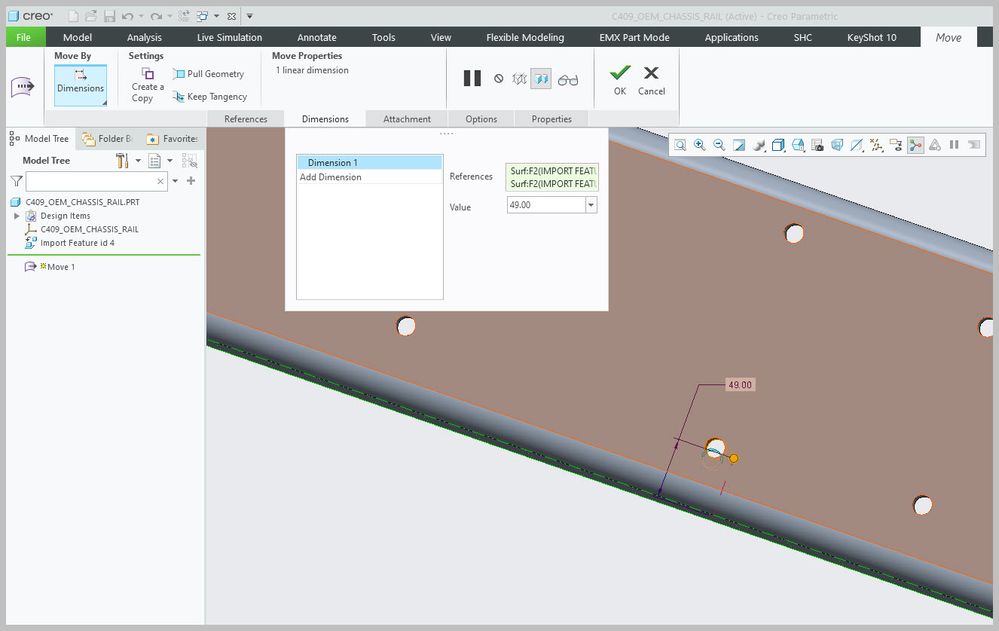

Using Move By Dimension in Flexible Modelling to adjust in Y direction causes dimension value changes in X direction in Creo Parametric.
There's a bug in the move function.
if you look at the sketch it shows one hole that is moved by the 'move' in the tree above.
The move is dimension driven and moves the hole from 40 to 49mm away from the bottom face.
The feature also moves the hole a tiny distance parallel with the face, which it should not.
You can see this by opening the sketch with the move suppressed and again with the move active, as shown in the two jpegs.

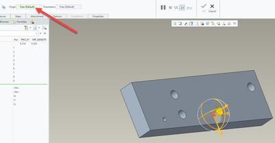

Here is a snapshot of the method used to move the hole.
StephenW
(To:JBrigham)
Well, looks reasonable. I am out of crazy reasons. Using native creo geometry, I couldn't recreate the problem.
If you can, open a tech support case with PTC and submit the geometry to them. They would likely be able to tell you were the problem is.

Every other CAD package I have used would not need a second reference to control a linear move.
Workaround 1
Article - CS313902 - Using Move By Dimension in Flexible Modeling cause other dimension value changes in other direction in Creo Parametric (ptc.com)
Workaround 2 from PTC support
"Add an axis to the hole upfront, include it in the move operation and dimension from the side surface to the hole axis.
In that case things seem to work fine.
Furthermore, I suggest you to request a product Enhancement (Product Idea)!
You can refer to Product Ideas @ PTC Community and consider posting a new one.
Thank you"
