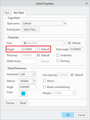

@pimm wrote:
I know for a fact that the text height changes when you begin a drawing based off the drawing format?
This is probably due to some of the text heights in the format being set to 'Default', meaning they will automatically track the default text height for that drawing instead of using a fixed value.
pimm
(To:TomU)
Hi Tom,
This is very strange.  I can't even find the heading of Note Properties so I can verify this.
TomU
(To:pimm)
Switch to 'Table' tab, pick a table cell, right click, 'Properties'.

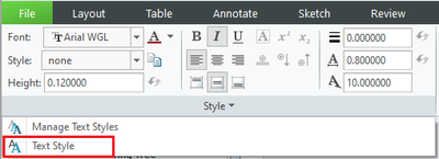

TomU
(To:pimm)
The other way to do this is go to 'Table' tab, click on table cell, switch to 'Format' tab, click the 'Style' down arrow (below font settings), select 'Text Style'.
pimm
(To:TomU)
Very good.  Thank you for solving this Tom.
This is such an unnecessary waste of time to reverse all of the defaults on a drawing format.  Thankfully it will only have to be done once.
I found that you had to go to the Table tab as you suggested and left click in a cell then right click to get the properties to appear.  No wonder I couldn't figure this out. ☹️
