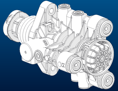

When opening this step-file on my Creo 8.0.9.0 I get the whole part, also with the all the inside geometry (which I don't need to know). The file is way to big to work with it in my assemblies.
Is there an import-setting or something that I can do to just import the 'outer surface' of the part? The inside can be a solid for me.

I can't set any geometry to delete with the DataDoctor so I don't think it would work / don't know what to do with it.
The Shrinkwrap would only delete 1/3 of the amount of surfaces when it still needs to look the same. Even if I do that and I open my new Shrinkwrap-file, it is empty.

If you only have the STEP file to work with and assuming that surfaces were exported.
(Need to set hidden config.pro option 'intf3d_in_as_part" to 'yes“)
1. Export assembly to STEP with 'Surfaces' geometry option selected in Export STEP dialog box
2. Open saved STEP file (Import as a Part) > In Model Tree select Imported Feature > RMB (Right Mouse Button) > Edit Definition
3. Enter IDD editing environment > Expand all the component features in model tree > delete unwanted surfaces & save the model
