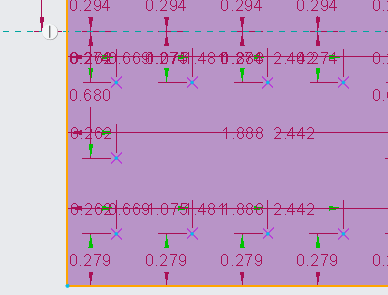

Here is a snippet of a part with circles imported from dwg/dxf. As you can see, I have an axis on what I call the origin circle to place my first bump, then I pattern this bump using a table that is defined by X and Y away from that origin bump.
However, if I was able to pattern that axis across all circles via pattern feature recognition, then I could pattern the bump as long as one of its constraints used the axis.
I will see about uploading some sample models if that helps.

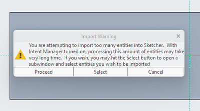

The issue is that this overlay is defined in AutoCAD or some other EDA layout tool and has to be imported in via dwg/dfx. I got this notice when trying to import <100 bump circles onto a sketch and it ultimately failed, so I'd imagine it would not be too happy with thousands. (Currently, we import the overlay onto the base model, without creating a sketch, using a coordinate system reference that matches the dxf, which works fine but starts to get slow around several hundred circles).
I thought about doing some post-processing of the dxf to place a point everywhere a circle is (not manually of course) and then import just those, but I'm not sure if Creo treats dwg points the same. And may have to do another conversion of those points to datum points if it does import successfully onto the sketch.

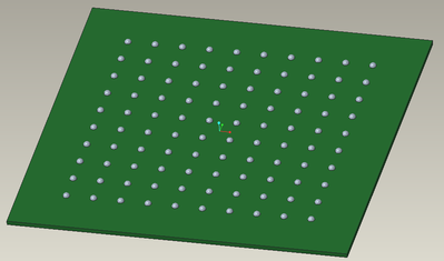

In the example below you can generate a fill pattern to get all of the balls without much work and would not need to obtain a dxf file to do it.
Example of 100 ball array added to a substrate using 2 features and a pattern of each. The second pattern is a reference pattern of the first (ball center locations) so it follows the lead pattern with updates. This regenerates very fast even using solid bodies with general option in the patterns.

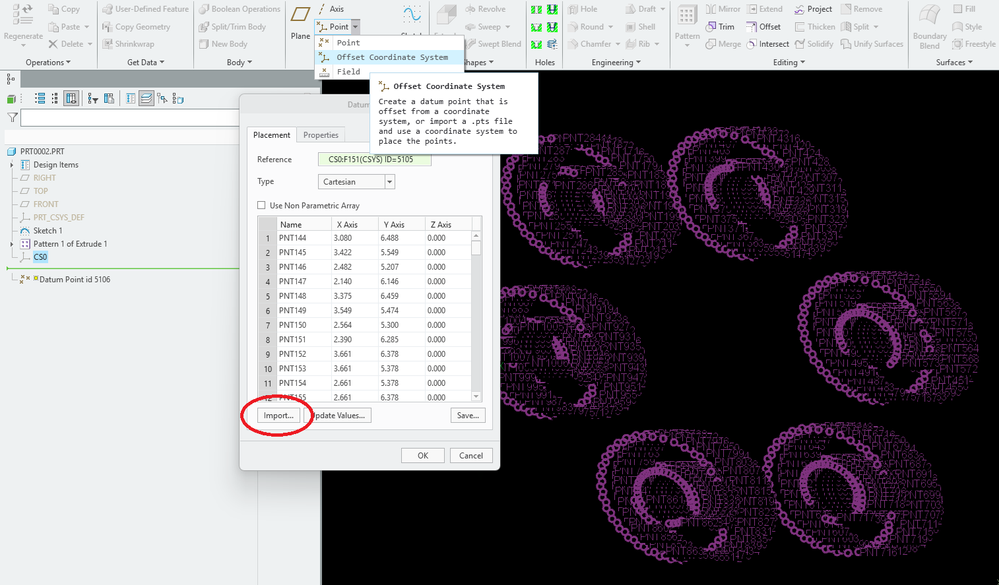

Thanks for the background of what you are working with. Are you able to disclose your company name/website so I can look at some samples of the type of packages?  I know that the Cadence PCB tools support the IDF interface, I am not sure about Cadence Virtuoso. If the IDF interface is supported or you can extract the data needed to create IDF interface files from output of Virtuoso package, then you can automate the creation of the Creo 3D models via the IDF interface. The IDF files are all human readable text files so scripting to generate input for Creo ECAD import should be straightforward if you can export the inputs needed from the EDA tools. If you can generate the needed input data, then you can then just model the package as an assembly in Creo and use the ECAD/MCAD process to place a solder ball on the substrate using the import file automatically. Once you have part models for each size solder ball they can be auto placed on import of the IDF files.
If you are stuck using Autocad DXF exports, then I would focus on creating datum point feature(s) for the center of each solder ball. I would first try creating a datum point offset from CSYS feature and include all of the ball centers in this single feature. Map the package origin csys from the Autocad data to the Creo model for each package and use it as the reference for the datum point centers. You can import the coordinates from file using the options shown below when creating offset datum point feature. Once you have the center points in the model then dropping the balls at the required locations is easy. You can revolve half a sphere on ball 1 and then pattern it referencing the point array.

I was baffled as how you got AutoCAD dwg/dxf points to go into your sketch, but then found that I had to set the configuration option intf_in_dwg_pnt_ent to yes.
with that aside out of the way, then since your import If data is only points, then one way to convert from imported construction points to actual points is:
1) select all imported points:
2) Right click in the graphics area, then "convert to solid".
(or even better to use SHIFT+G shortcut instead)
But the problem is that the sketcher will likely fail to import a file with even 100s of points - nevermind 1000s.
So I'd use the AutoCAD PTEXPORT utility (link in discussion) to get the coordinates of the points into a .txt file.
Then the .txt file has to be massaged a bit - replace its commas with tabs, rename it to .pts file
Then you can import that into a datum point feature:

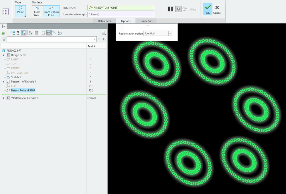

 One last thing to mention is to use "identical" pattern if you can:
