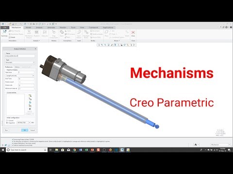

If it's indeed a square push button which can translate up and down when activated / deactivated, I would actually suggest using a Slider mechanism connection. And as suggested, you should create the push button and the square "hole" with axes down the center for Axis Alignment of the Slider connection.
Here's a video that has a Slider connection: https://youtu.be/J_YNvWWA13E
You could then use Mechanism Snapshots to capture the different positions of the button.

This Creo Parametric tutorial video shows the process for implementing and analyzing a mechanism in an assembly. It shows a Slider connection for a linear actuator (model from Thomson Linear), setting motion limits, taking snapshots, defining a motor, and running a kinematic analysis. Every ...
