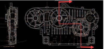

hi mahesh,
i'm having the same issue, i know the procedure for aligned section view but after following all this i'm getting this error " All lines in cross section must intersect axis. Pick another axis " which axis needs to be picked for aligned section view.
I have tried all axis randomly available in model , See attached picture of drawing and what I'm trying to do.

The way you have it drawn with the angled line would make it need to rotate around 2 axis to align. Make the line horizontal in between the vertical lines then you don't need to use an aligned section, just a normal offset x-section.
