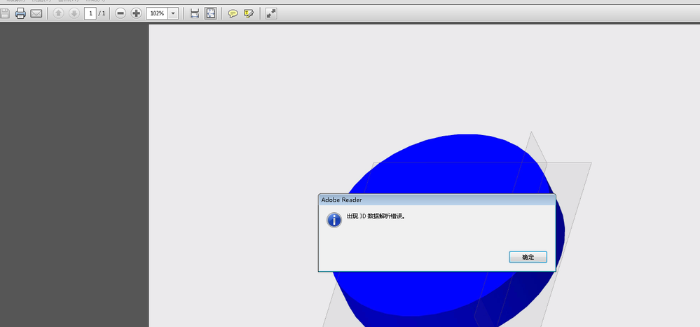

ProPDFExport 3D PDF but open it show data parsing error
ZHeiTu
protoolkit: When ProPDFExport exports U3D PDF and opens it, it shows a 3D data parsing error无标题.png111.png

在屏幕截图中,代码显示,在使用 ProPDFExport 导出 U3DPDF 之前,设置了 PRO_PDFOPT_EXPORT_MODE=PRO_PDF_3D_AS_U3D_PDF 等参数。我使用了 Adobe Acrobat pdf 查看器打开的 pdf。开发环境为 Visual Studio 2019
remy
(To:ZHeiTu)
The first thing you can try is to export the same file from the UI and see if the parsing error happens there.
Secondly, I'm seeing that you set a series of properties. Did you try by elimination ?
Just comment all but one property, try and iterate. This will help pin down the property that's not mapped properly (if I understand the error correctly).
ZHeiTu
(To:remy)
I tried UI is used to derive the same file, and view the parsing is no problem, I tried to set up ProPDFOptionIntPropertySet (pDFpotion OPT_EXPORT_MODE, PRO_PDF_3D_AS_U3D_PDF) but there are still problems,
remy
(To:ZHeiTu)
If the export from the UI passes then the issue lays in your code.
Try by elimination : set one property after another and iterate.
If this still fails, flip your methodology and re-use the code in the resolution of this article : https://www.ptc.com/en/support/article/CS61272
Make sure it works and then iterate to your likings.
