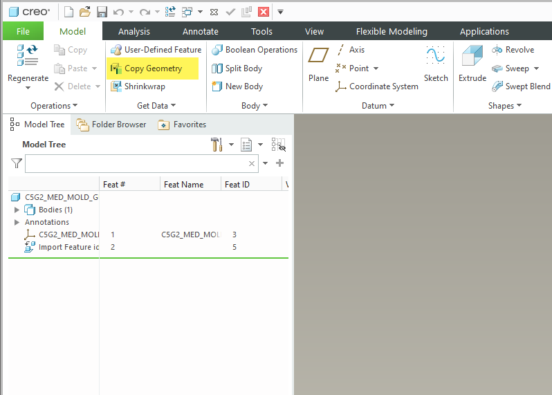

Could you give me the keystrokes to find out?  I work for a small company with scant tech resources.  We have no I.T. nor any windchill admin.  We do it on the fly.  I have no formal training, just a few online tutorials and some solid OJT.  2 years.  I don't follow all the terminology advanced users are referencing.  The only reason we use Creo is because our larger customers like Caterpillar use it.
tbraxton
(To:USER_09)
If you can use this copy geometry command, then you should have the license for top-down design tools.
To Create a Copy Geometry Feature (ptc.com)

Indeed I do kind user.  help me with the words to bring this idea to the team.  Some know more than I, but are way busier.  We have some users that were on Pro-E (or what ever it was called ) at the beginning.
