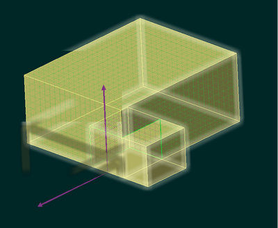

I have some basic geometry that when merged presents different solutions based on the order in which the merge reference quilts are selected. I am not able to explain this when considering the boolean logic resultant from the set intersection. 3 Unique solutions are available depending on the order in which the merge reference quilts are selected.
Can anyone offer an explanation as to why this is the case? See the video for a detailed explanation of my observations. Creo 7.07.

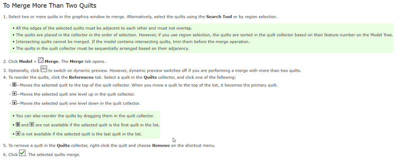

Maybe this is helpful? It seems that the first quilt in the list is the parent quilt (the one you're modifying). The subsequent quilts are the ones that you use to modify the parent quilt. In my experience, this logic seems consistent with the other merge commands in Creo (component operations > boolean > merge, data doctor merge).
I recommend using the preview that is mentioned here (#3). It's very helpful to see what the merged geometry will look like.

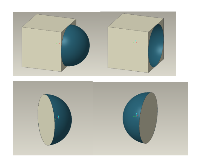

Consider this geometry and compare the results to my test model above. There are 4 unique solutions here as I would expect and I can generate all 4 regardless of which reference is selected first. i.e. if one reorders the quilts, the resultant solution does not change. This is not the true for my test model in the original post.

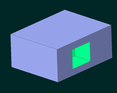

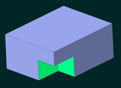

This test model shows the results of the merge before / after reference swap:
After "swapping the quilts" (used the edit references tool), result is quite different:

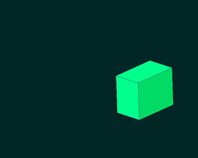

nevermind, same results if the quilts do not have overlapping surfaces:
vs
