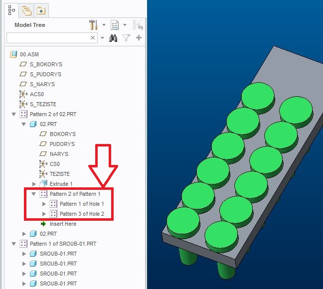

"BOTH" choice works different way, than you expected.
If you use pattern of pattern in part, than BOTH will be unlocked in assembly pattern of screw... see attached model tree picture:
@mbonka
