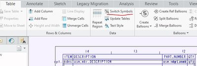

I'm running Creo 3.0 M050, and have a problem where I'm trying to create a BOM in my detail drawing of an assembly. The table is placed in the drawing and a region appears to be set, as the table shows the correct number of rows for each part in the assembly and I can apply balloons to the views. However, the table is not populating data in the columns, even for "rpt.index". What may be the cause and fix for this? Also, I have created a hole table for one of the components in this drawing, could I have fouled something then trying to do this?

Does your drawing have more than one model? If so, maybe you had the wrong model active when you added the bom table.
Just verify you haven't hit the switch symbols icon in the ribbon.
Table relations are in the menu manager when you pick the repeat region icon in the ribbon.

Okay, so I executed TABLE>DATA>SWITCH SYMBOLS and the table is now populating as I would expect. Must have inadvertently executed that previously that caused my issue in the first place?

kdirth
(To:mo185028)
If you Have the same issue as the original post - complete table, BOM balloons populated, no data shown in table, go to the Table tab, in the Data section is Switch Symbols, select Switch Symbols to show the data.
