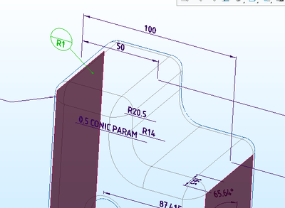

  • Assign colour to surfaces that have the revision.
  • Prefix the dimension that has changed with a symbol. Assign references to the surface to which the dimension refers to. That way, when the dimension is selected, the surfaces would be highlighted.

Create a Revision Symbol with Variable Parameter for Revision (A, B, C or R1, R2...)
Insert the Symbol and create references to the surfaces that have changed.
Symantic Query would highlight the Surfaces that have changed.
