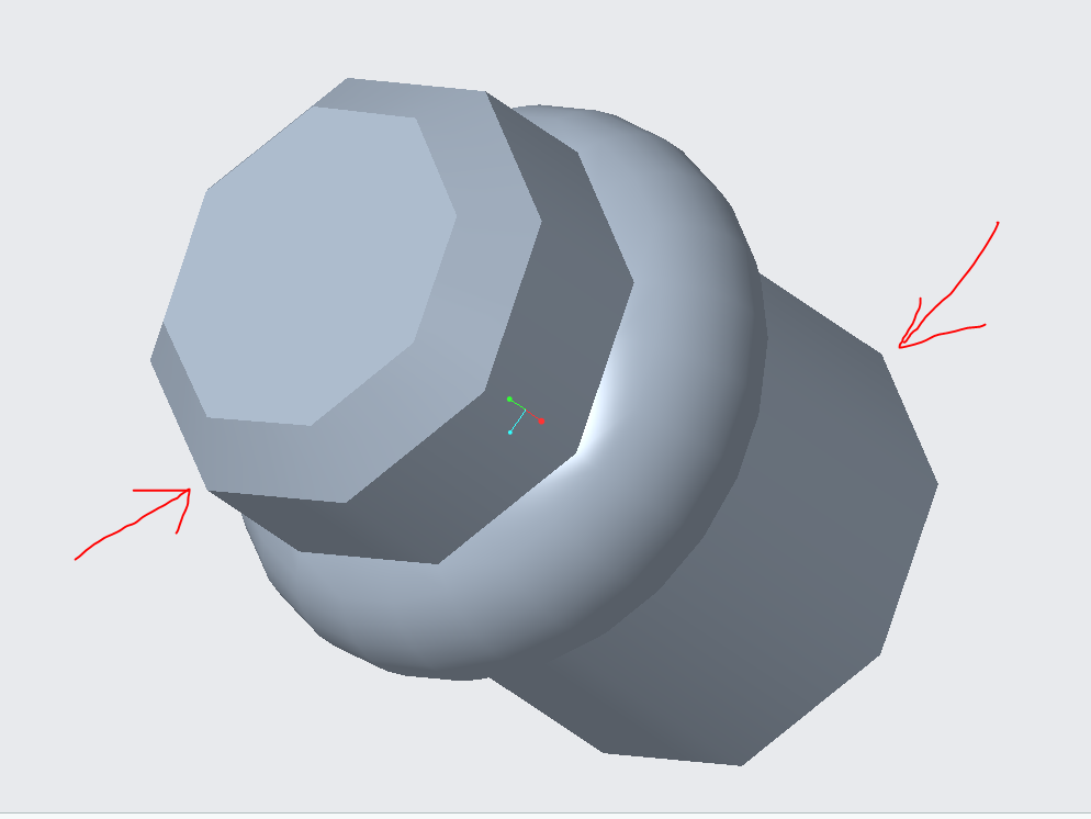

Hiii Good Morning all,
I have just started to learn Creo, I have installed Creo 10,
while revolving i am getting issue, instead of round it is coming hex revolving,
2 REPLIES 2
Check chord height to control curved surface resolution high values make circles look like polygons change it in file > options > model display find chord hieght and lower it. Also facet surface display creo settings affect facetted surfaces low resolution can make curves look like polygons adjust in model display options.
Perhaps you are experiencing the same as the person in this discussion:
https://community.ptc.com/t5/3D-Part-Assembly-Design/Revolve-result-is-not-smooth/m-p/906754
