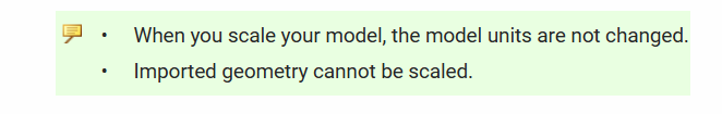

Have you tested this on imported geometry? If it worked, please post what version of Creo.
PTC docs explicitly state imported geometry will not get scaled.

No, it is not possible to scale imported geometry using the scale model function.
Link to specifications on this:
To Scale a Model (ptc.com)

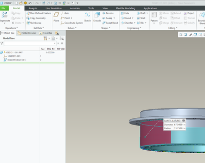

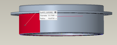

We build molds and want to scale the model because of the shirinkage, but also want to keep the model in the orriginal dimensions.

I have scaled imported step files no problem using the scale function. Are we talking about something else? I just tried it with a step model and it scaled perfectly.
Jan_Venema
(To:Chris3)
that is right but if the feature is extern copy then it doesn't work, also doesn't work with units.
