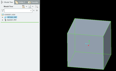

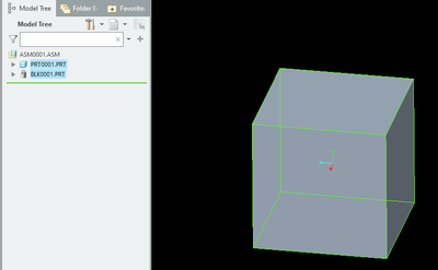

Thank you for your response and video.  In your video, all of your 2d box selections are from left to right which requires a target model or assembly to be completely inside the box.  The issue I ran into involves a 2d box selection from right to left which only requires me have a small portion of the target model inside the box.  I created a simple assembly based on your movie with a box and a bulk item.

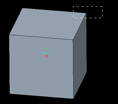

Doing a 2d box from right to left and catching just the upper right corner, I only select the box.

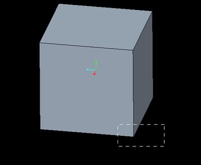

Doing a 2d box from right to left and catching just the lower right corner, I select the box and the bulk item.
I understand your example using left to right box selection but I do not understand the results for a 2d box from right to left only selecting a portion of the same target in two different areas and getting different results.  Thank you again for your time.
