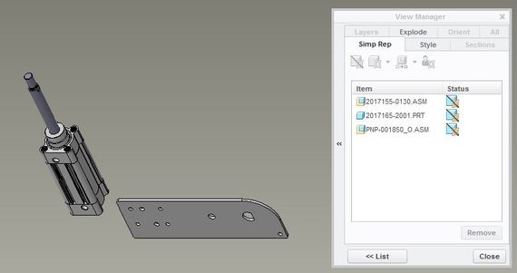

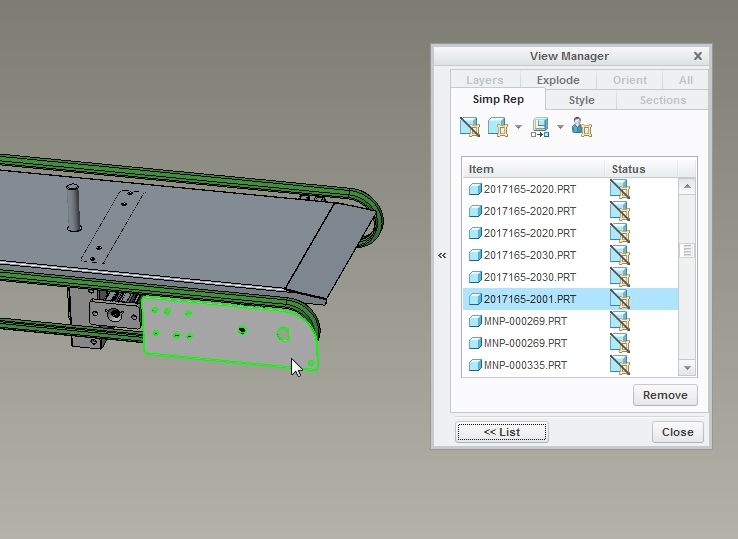

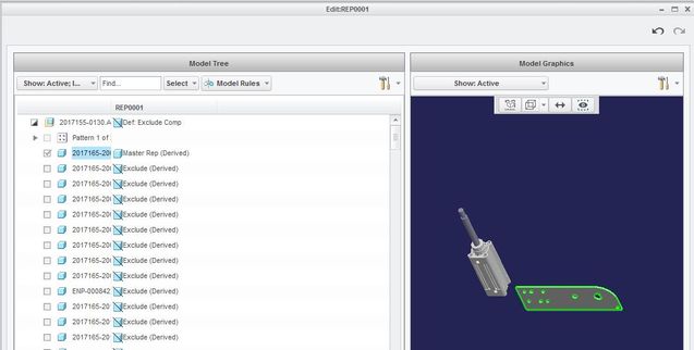

we are working with Creo3.0 M120 and we are using the simplified representations quite a lot in assemblies to create some partial BOM-tables in drawings or to make our large assemblies less "heavy".
Now we have one part in an assembly which won't be excluded in the simp reps of this assembly.
In the screenshot below you can see that the part is selected and put on "Exclude". But whatever we do, the part always stays vissible in our assembly and drawing.
Does anybody know what the problem might be? We had this problem once with another part, but at that time we were not trying to fix this problem...

hello,
I think that part is in some other subassembly, isn't it???

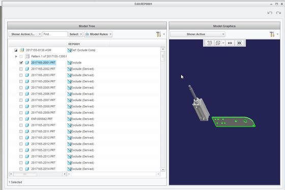

Pleae check "Redefine" option to that simple representation. Right click to the representation name and redefine option.
You will find a Edit dialogue box with two small windows, ''Model tree and model graphics''.
Click on that part in the model graphics window and see the model tree will be opened up to that part...
Please check options for that part in that model tree, 'Exclude or Exclude derived'
Or If possible please share picture of that Edit dialogue box model tree.

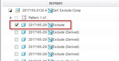

I've tried this, but 2 parts are still vissible, even when they are on "Exclude":
Even a forced regenerate in the model-player isn't giving any solution...
By the picture it should not be appear in the model and drwaing.
But, Please click on that mark in front of the part, so that mark will be gone.
And it will become ''Exclude derive''
hope so it will work
That mark arrow in front of the part has to be gone.
Please try it
See attached picture

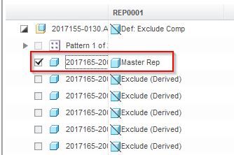

Here might be the problem be, because I'm not able to un-mark the part.
You can see that the mark is still grey... And if I click the mark, it will be black and the part will be on "Master Rep" and if I click another time it switches to "Exclude".
For the other part (the cylinder) it's exactly the same.

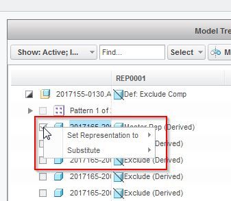

If I click with the right-mouse-button this menu will appear:
123.png1) If assembly of that part is in''Exclude'' then by selecting ''derived'' option, that mark should be gone and that part should become ''Exclude derived'' For an example:------>
2) As per u said, By clicking that mark, It becomes dark and part becomes ''master''.
And by clickind second time on that mark it becomes exclude.
I want to know that, After second click the mark is still there????
If part becomes unmark and it is in ''exclude or exclude derived'', It should not be appear in model and drawing

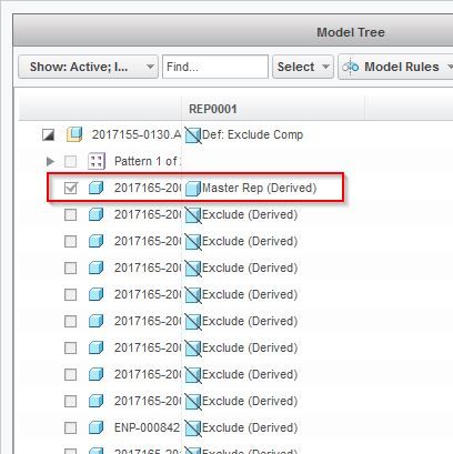

You can see, if the part is on "Derived" the mark is greyed out:
If you push ones on the mark, the part will get on "Master rep" and the mark becomes black:
If you push twice on the mark, the part will be on "exclude", and the mark will stay black:
There is no way to get this mark (grey or black) away...
