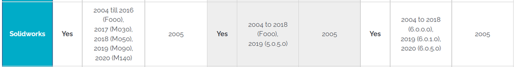

Can Creo4 import Solidworks 2021 part and assembly files?
What about the newest versions of Creo?

Here is the long version of the same answer.
Compatibility matrix in this link.
https://www.ptc.com/en/support/article/CS134024

BenLoosli
(To:pausob)
I don't think so. I just tried a SolidWorks file I got from GrabCAD that I think was done in SW2021.
Creo 4 failed to open it.
Creo 7 did open it.
Generally, the version of Creo must be newer than the version of the other software.
