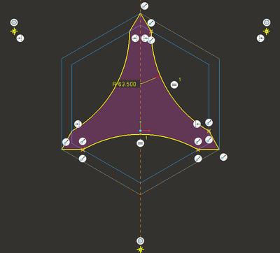

Does anyone know how to construct that star shape with a simple white spine?
I cannot get rid of the central lines generated by the corners of the three spikes, tried blending to a point or to a smaller star point, to no avail.
And when trying to round those corners with an arc, I am having issues with connectivity between the arcs and the segments, and I am not able to get rid of those errors (no idea how to deal with them).
Any suggestion is welcome!!

Fully constrained sketch of the shape using your example pic as construction reference. This is not the only way to get this sketch done, it is based on the reference image you provided. I used the hexagons in 1 sketch as the reference to create the "star" shape.  As indicated by the shade region the sketch is closed. I did not have to use any trimming operations to get this result.
In Creo Parametric, one should in general keep sketches as simple as possible. This is why I used 2 sketches to make this.
This same sketch can be created in a single sketch using two concentric construction circles in rather than the hexagons.

The lines in the middle are still there, regardless of the closed sketch.

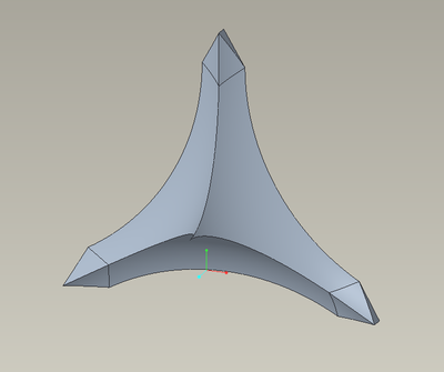

This was about obtaining a smooth surface inside the star when I perform the BLEND, I cannot get rid of the green lines that I drew in the attached picture.
kdirth
(To:cgherghe-2)
Are you trying to create a surface with a boundary blend from the sketch?  Boundary blend always creates lines between vertices on each side.
If you are creating a planer surface, use Fill.

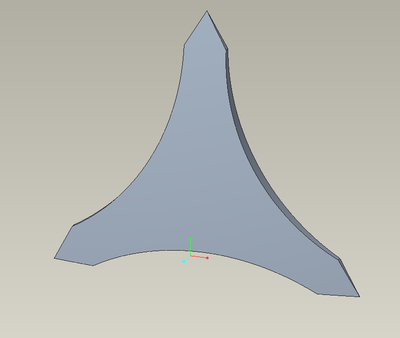

tbraxton
(To:cgherghe-2)
It is not clear what your objective is. If you are attempting to build some 3D geometry provide some pictures of what it needs to be. Here are two options of using that star to create solid geometry, are either of these representative of what you are attempting?
