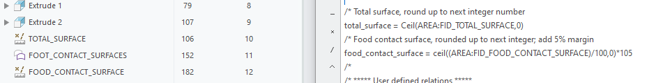

We are developing home appliances for food preparation. For regulatory reasons we need to provide the total surface and the surface in contact with food.
For a part I created feature measuring the area of the body to get the Total Surface. The I created a copy surface feature and again a feature stating the area of these copy surfaces. Using relations I created parameters which then are used in annotations. So far so good.
For convenience reason I tried to add this features, relations and parameters to our start part. Unfortunately the measuring and copy surface features fail if no geometry exists in the start part. I wonder if there is an option to add these features differently. Any hints?
Cheers, ziegi

So you want to have a start part that has a measure of a surface area of a copied surface that hasn't yet been defined (source does not yet exist)?
I am not seeing how that would work - without at some point, having to define the references of this copy feature so that actual geometry is measured.
One way, would be just to have a start part with the failed features suppressed.  Then once the geometry is there, resume them and then edit the references of the copy feature...
Or, why not just keep a "demo" cube in your start part, design your part, edit the references of the copy feature and then delete the cube?
I also recommend that you read up the help on user-defined-features (UDFs) and maybe also annotation elements and see if those would work for you.
BTW, foot contact surfaces should probably never be food contact surfaces ðŸ˜€

You got the challenge. I will have a look at UDFs and annotation elements. I'm not in favour of the other options, as they will confuse co-workers using the start model.
May 25, 2022
Either way, you will have to explain to the end user what to do.  And to clarify, the UDF I had in mind simply had the 2 analysis features and the annotation feature & its elements.  The body and the copied surface would be created before bringing in the UDF group.
Good luck!

Measuring and copy surface features fail when no geometry exists in the start part. Which is inconvenient because a start part by essence has no geometry in the first place. Your start part then is flawed with regeneration error and you need to make the life simple for your users.
Your measure features exist under the condition previous solid features exist. So you need a conditioning mechanism.
Did you explore Pro/Program? where you can add some script in the background of the part.
Not sure though how to "detect" solid geometry with it.

There seems to be no easy solution. I will have a look at UDFs and Pro/Program, probably in combination with a mapkey. Unfortunately this has low priority on our side.
