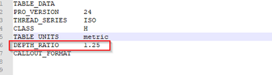

DEPTH_RATIO
The relationship between the thread depth and the drill depth (for example, 1.25). When you enter either the thread depth or the drill depth on the Hole tab, the other value is calculated automatically using this ratio. Drill Depth is Thread Depth multiplied by Depth Ratio.
* You can override the default relationship of the depth ratio by entering both the Drill Depth and the Thread Depth values on the Hole tab, under the condition that the drill depth value is greater than or equal to the thread depth.

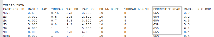

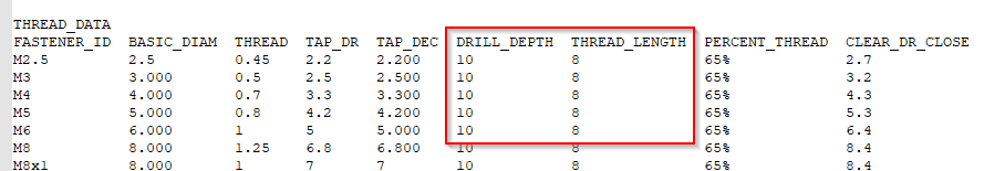

I'm trying to integrate the parameters THREAD_LENGTH and DRILL_DEPTH in my hole-table, but this doesn't seem to work. (see attached hole-table; I've put ".txt" in the name, because otherwise I wasn't able to upload the file).
What I want to have, is per hole-diameter a pre-defined drill-depth and thread-length (to test, in my table this is for each diameter 10mm and 8mm):
In my hole table I still have the DEPTH_RATIO on top, but when I will remove this, my table doesn't work:
For the rest I don't really know what the parameter "percent_thread" does mean...
I've allready checked the link below, but this doesn't help me a lot: http://support.ptc.com/help/creo/creo_pma/usascii/#page/part_modeling%2Fpart_modeling%2Fpart_nine_sub%2FUsing_Hole_Charts.html%23
TomU
(To:gpeetersem)
I think you are misreading the statement from the help page.  It's not saying you can override these values in the .hol file (by adding extra columns), it's saying you can override them (one at a time) in the user interface (hole "tab") when creating the hole.  To the best of my knowledge it's still not possible to control hole depth AND thread depth in the .hol files.  See CS99906.
gpeetersem
(To:TomU)
Hi TomU,
thanks for your answer. So now I know that I don't have to search for a solution...
In that link it explains that percent_thread is the ratio of thread to major diameter. In other words, the major diameter minus the tap drill diameter divided by a constant times the threads/inch.
See this link to explain it better: http://www.balax.com/catalog/technical-information/thread-percentage-calculation
