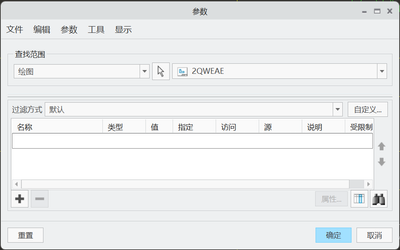

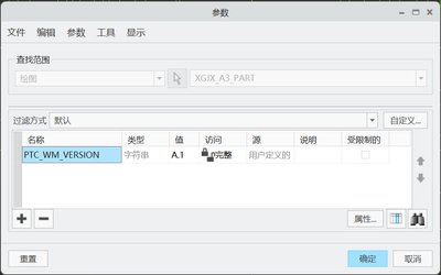

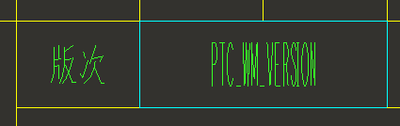

There are revision parameters in the 2D template I made, but after the new project drawing, the revision parameters are not called successfully, and the parameters are lost. How to solve this problem?
  2D template:
New engineering drawing:
  • System parameters are not created nor populated at object creation
  • System parameters are only created and populated after Save and Upload to PDM servers

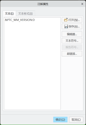

Just to add to Martin's solution:
In the first image, you are showing the parameter "&PTC_WM_VERSION:D". The D on the end refers to the Drawing's parameters.
The second image is showing the Model's parameters.
These are separate. To view the Model parameters in the drawing, the Model must be Saved and Uploaded to Windchill. To view the Drawing parameters in the drawing, the Drawing must be Saved and Uploaded to Windchill.
