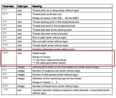

For thread turning there are actual not all Parameters in Creo aviable, with I can use on the machine.
An example is the Parameter "IANG" of the Siemens Cycle 97.
Another example is the Cycle 98.
With this cycle, it´s possible to produce chains of threads with different Diameter and angles.
Please add those functionalities to Creo
