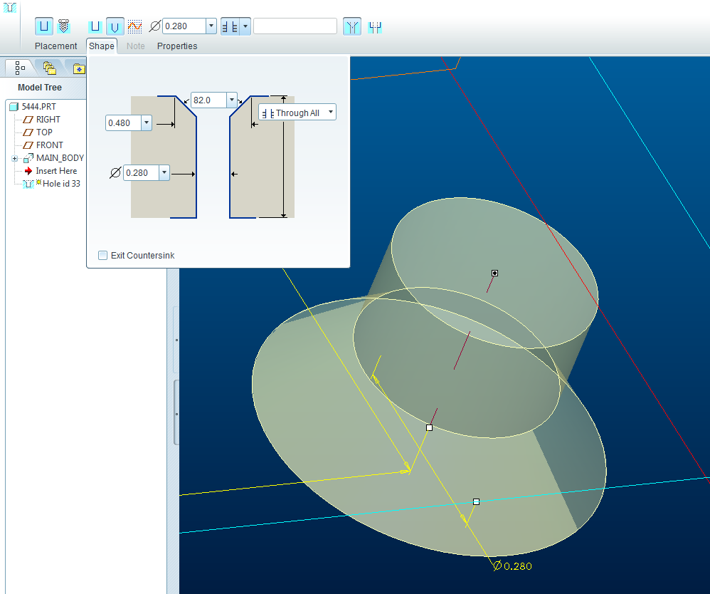

I have a part that has some holes that are laser cut by a supplier and then internally to the company, have a chamfer added.
Is there a way in the Hole Tool to toggle on and off the chamfer through family tables so that I can have a vendor supplied part and then a finished part?
Currently, it has been on the same drawing with a note, but scheduling/recieveing is asking for it to be broken out.
Thanks, Dale
Best answer by dgschaefer
I don't think you can toggle a part of a feature on and off. I'd suggest making the holes without the chamfer and adding the chamfer separately with the chamfer feature and toggling that on and off.
Alternately, you could have two hole features, one with and one without the chamfer and switch between them. That would require some careful management to make sure they remain the same if the hole size changed.

I have found a work around, but would still be interested to know if you can just toggle off the chamfer.
In the family table, I added the dimensions .480 Diameter and 82 degree chamfer. I changed them to .281 diameter and 1 degree chamfer so they are not really noticable. But I'll have to do this for six holes.
Dale_Rosema
September 8, 2014
Your first suggestion was what I was sort of thinking, but was just check to see if it was possible. The second idea leaves to much to be updated if the feature changes - myself or those that come behind me would have to remember to change both and for that, there is no gaurantee.
September 8, 2014
Yeah, that was my thinking too, but if company standards or something required that it all be in the hole feature, that'd be an option.
