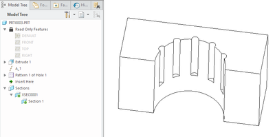

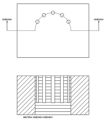

kdirth
(To:Sandy1)
I agree that this is something that CREO should be able to handle.
They appear to have not put in the effort to make it work in a shaded view.  It does work in a line view and partially in a drawing.  The cross section lines in the drawing are a bit messed up, not maintaining the angle through the arc.  Images below.
kdirth
(To:Sandy1)
Looking at the messages while trying to create the section in 4.0 I get the following message:
"Offset sections that include arcs or splines cannot be displayed as clipped in shaded mode."
You can use arcs and splines to create an offset section.  However, for whatever reason, you can not show the section in a shaded mode.  Works fine in wireframe.
