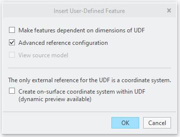

pimm
(To:Chris3)
Chris,
One of the biggest parts of this being cumbersome apparently was in the way I created the UDF.  (Which is the only one I ever built).  My UDF adds a unneeded plane whereas your's does not.
The only thing that to me prevents this from being streamlined is an extra screen that doesn't seem necessary.
I am wondering whether the above screen could be bypassed as I have only been using the above checked option.  Perhaps this is unavoidable but it would be great to have just one entry to make this streamlined.
I see the extra screen with the 2 UDF's that I already have so perhaps this has to be there.
This is better than what I have, thank you.

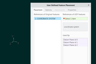

pausob
(To:pimm)
I suggest you do both.  You have the UDF, now make a mapkey which will start the UDF feature, select the gph file, press OK to the dialog shown and then stop.
At this point, the system waits for the user to select the reference:
