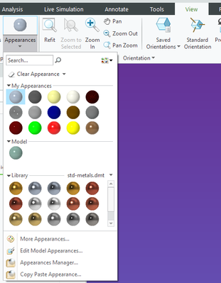

Where do you check the part appearance color?
kdirth
(To:cgherghe-2)
Select appearances dropdown.  In the Model section will be all appearances applied to the model.  As far as determining what each one is applied to, you can RMB an each to select objects with that appearance.  With objects selected you can change all to a new appearance.
