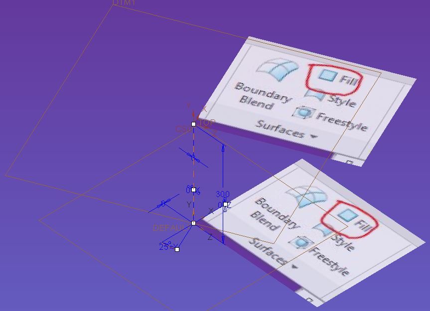

When I draw a line in Creo 3.0, I can put the line at any angle except when it gets close to horizontal it snaps to horizontal and the same with vertical.  The image attached shows a step line is okay but the centerline in the image is what I want to trace along.  It is such a small angle it snaps to the constraint.  I can hold the "shift" button and it releases the constraint but as I continue to trace that centerline wants to go horizontal later on.  It would be nice if I could rotate the image by .6° counter-clockwise to make the image's centerline horizontal.  So far I have not been able to find a rotate button under the View/Image/Orientation ribbon.
dgschaefer
(To:Scott67)
The only way to rotate the image inside Creo is by the green drag handle and it is pretty difficult to rotate by very small angles.  You'll probably have better luck rotating it in an image editor outside of Creo and the importing the corrected image.

kdirth
(To:Scott67)
To accurately place an image rotated at a small angle, create a coordinate system that is rotated at the desired angle.  Next create a plane from the coordinate system.  Now you can place the image on the new plane and it will be rotated at the desired angle.
