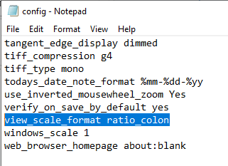

Our config.pro has view_scale_format ratio_colon (1:1) which does not seem to be mapping across correctly

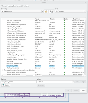

In Prepare>Drawing Options>Detail Options> view_scale_format is default to decimal* (1.000)
However, '&scale' displays a fraction (1/1)

No. You cannot configure this at format level, because Details Options (access from >File >Prepare >Drawing Properties >Drawing Options >Change) does not even propose any entry labelled view_scale_format in the scope of formats objects (upon definition or redefinition), and this is expected (see attached snapshot).
As a setup for the future to get this automatically (without having to notify users each time), you have therefore no other choice (as far as I know) than configuring it in your Drawing Template Object (where template_drawing config option can later point to). And this Drawing Template can be preconfigured with the format (from *.frm file) you want.

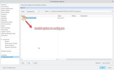

view_scale_format is a DTL Option (in Drawings), not a valid config option. I tried to check one very old version of Pro/ENGINEER, and it was also not allowed (check attached snapshot), so not a regression for sure (but may be an intentional change of behavior if this was supposed to be handled by config.pro setting in pre-Wildfire 3.0 versions, not sure here ...).
In your first snapshot, you show presence of this option withing config.pro in a text editor, but I suppose that if you access >File >Options >Configuration Editor and scroll down to this option, you will probably see something like this (please confirm):
Therefore, there is no other choice than driving this behavior from DTL settings (>File >Prepare >Drawing Properties >Drawing Options >Change), according to guidance documented in Detail Options section (near the end of the page) of Creo Parametric 8.0 Help Center.
Considering above, how to deal with this now?
  • For new drawings, it's easy: Just configure the expected value of view_scale_format in your drawing template object, according to guidance in articles 120556 or 33947
  • For existing Drawings (containing wrong definition of view_scale_format), consider a mapkey which will change this to reconfigure the value of thid DTL entry according to what you need.
