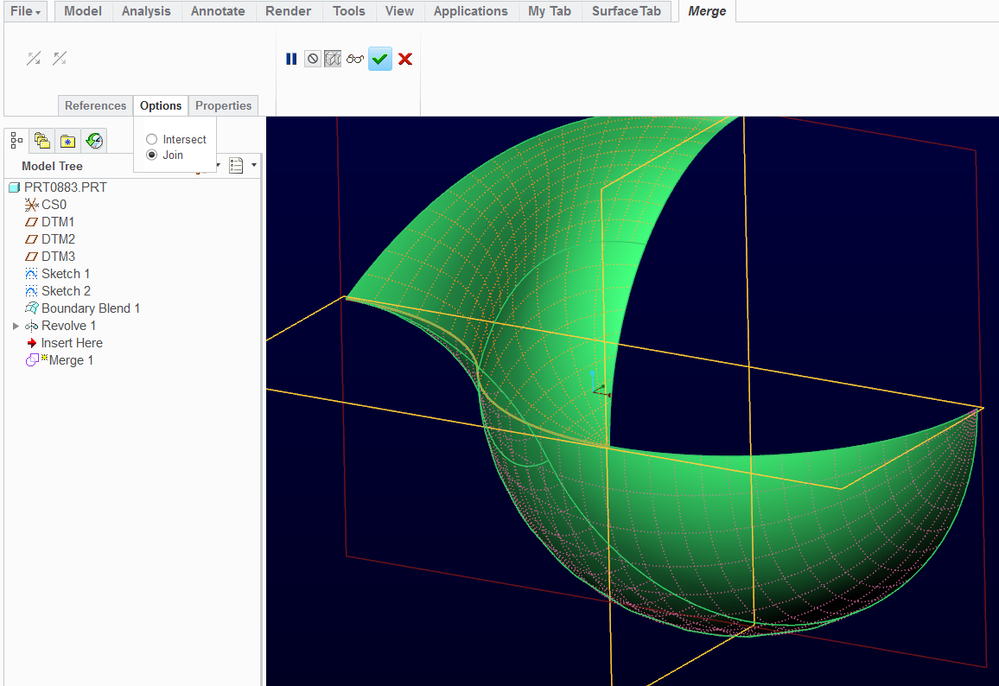

Hello everyone! I have a problem with two surfaces that won't connect to each other.
When i click on Surface Connect and click my Two surfaces.. Nothing happends when clicking ok.
Is there a possibility to solve this problem? Thanks in advanced!

Let me suggest another means to attack your challenge...
One thing that works well with stylized design is to "extend" surfaces.
Bring the edges of your surfaces out further and trim them to shape.
The red dot is what I am going to refer to as a "knot".
This often happens when you force a surface definition into a corner.
Remove the corner by "extending" the surface definition.

Merge - ... is in the model tab.  Highlight both surfaces and the merge feature icon should highlight.
Won't work.. Tried several times..
Then there is probably a mismatch between surfaces.  I see a knot in the triplet corner.
How could I solve this?

I did make one where the merge failed to intersect but would join without issue.
This is a revolve and a boundary blend with one free and one normal interface.
Style is a very powerful tool.  I wish I had it just to play around with it but with the never ending cost of maintenance I cannot justify it.  However, part of the Style package is to manage surfaces to the N-th degree.  I would hate to spoil a good learning experience by shortcutting the way we do things in core-Creo because we have to.  For most situations, this is more than adequate.  But it is well known that core-Creo doesn't stand a chance with high quality surface requirements out of the box.
For now, use your analysis tools to test the true quality of your surfaces.  Someone will weigh in on the Style specific tools to solve your issues.
I did tried this. But still in the reference, it shows a red dot on the part. And i cannot merge those two

Great it works!!! Thanks!!
