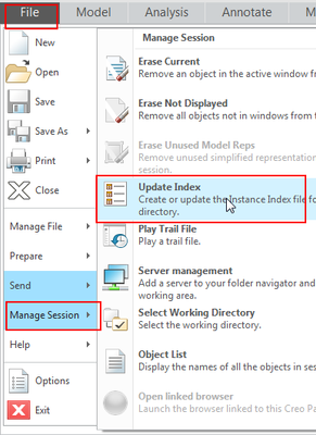

Hi Ronan,
I think you have your generic part copied to the ifx_fastener_data folder. This will not work.
Please move all your fastener to Windchill (if available) or move them to a archive folder.
Then set a Creo option search_path to this folder.
I recommend to update the index in this folder
Update IndexUpdate Index
Then the files can be found by IFX and of course by Creo if you reopen the assembly.

Ronan
(To:OliverGräbner)
thank you Oliver, that works fine now  Smiley Happy
