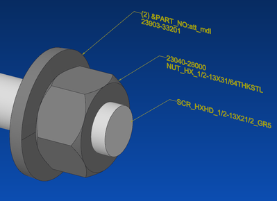

We are also looking into MBD... The problem I'm having right now is with Assemblies.
I'd like to show a BOM with callouts in the model... (We would like to get away from drawings altogether.)
I'm missing it somehow.  Surely there is a way to do that.

I think most of us have an ERP system that manages the BOMs... but one of our Divisions still puts them on the drawing.  It's nice having a comprehensive document.
Balloons with intelligent Find Numbers would be good ...

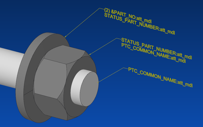

My immediate need today is to be able to add attached leader callouts with the Part Number (without the file extension).  Part Number, Description and Qty would really be cool.  Sometimes, especially during development, this would really be handy.
I've experimented and had some success with Attached Notes although I can't always find the Parameters I need.  I was hoping I could do this with a Symbol so I could hard code the callout syntax.
There may be a way I can do this in CREO 4 (creo 6 later this year) but I just haven't figured it out yet.
