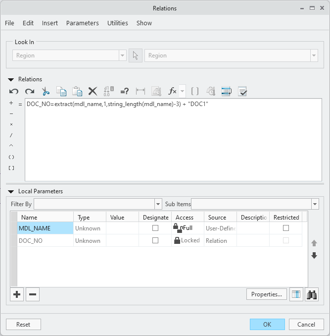

Drawing programs have a greatly reduced subset of valid commands.  You should be able to display this on the drawing by using a single cell repeat region as long as you don't actually need a drawing parameter populated with this value.  What version of Creo Parametric are you running?
TomU
(To:TomU)
Example with Creo Parametric 8.0

TomU
(To:BenLoosli)
That will work as long as they want to add the relation to the model, but it won't work in a drawing unless it's added to a repeat region.

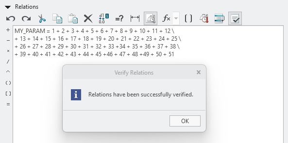

@BenLoosli wrote:
Relations do have a limit of 80 characters.
... for a single line.  You can continue a single relations statement on as many lines as you want, you just have to use the continuation character ( \ ) so each line doesn't exceed 80 characters.
