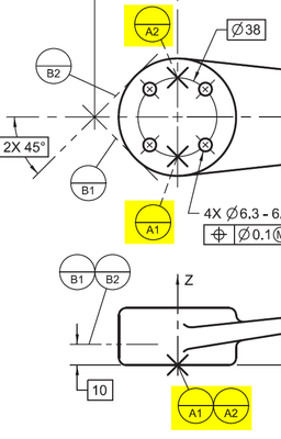

We are on CREO 8.0.  I have a part with datum targets, very similar to the connecting rod in ASME Y14.5.   I would like to show the "merged" (think, merged BOM balloons) datum targets like the attached picture for A1 and A2.  The only work around I could come up with is to create the two bottom view datum targets A1 and A2, and then turn off the point and leader line display of target A2.  Then I can "fake: the position of A2 to look like the two merged A1 and A2's in the attached picture.  THE downside is that they are NOT connected to each other and moving A1, does NOT take A2 with it.  IS there a better way?
thanks in advance...
