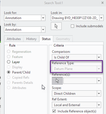

I have several questions about the nested query:
1) In the status tab, i can only select datum_plane in reference for parent/child critera. And as the datum target are put ine the drawing, there is no ref plane.
How can i select an another option, it was grayed out?

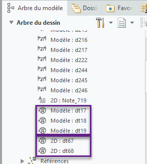

2) the name of the symbol is DATUM_TARGET (it is a creo Symbol)
Iif he is put in the 3D model, in the drawing tree it appear as follow
And if put in the drawing, it appears as follows:
How can i search it with the draft critera?

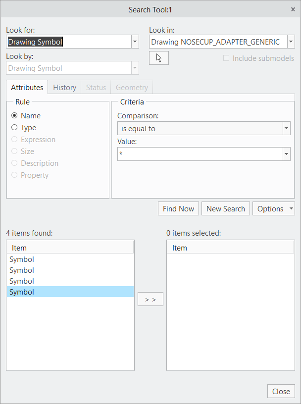

The objects you are noting in the previous post are drawing symbols. This is the search criteria to find all symbols in a drawing.
Unfortunately, the documentation on the search tool is lacking so you will need to solicit feedback here and contact PTC support to drill down into this. I am not familiar with all of the options within the search tool. Ideally PTC would document a matrix for every data type that is searchable and note the query construction to find them in the UI. I am pretty sure the developers have such a document but as you have probably discovered the help files are only an introduction without the detail required to understand the function thoroughly.
