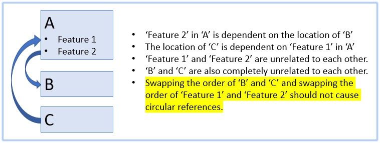

TomU
(To:tbraxton)
@tbraxton,
At the risk of confusing the original poster, I want to throw something else out there...
Creo is now classifying features that are not in its 'preferred regeneration order' as being circular references.  These are often listed in the .crc file as 'must follow after'.  These can occur with features that have no relationship to each other at all.  I went round and round with PTC about how 'preferred regeneration order' issues should not be called 'circular reference' but I got absolutely nowhere.
Here is a picture attempting to visually describe the problem.
Take note of the text in yellow.  Swapping the order of features 1 and 2, or swapping the order of components B and C will cause a circular reference error to be triggered, even though there is no dependency between features 1 and 2, and no dependency between components B and C.
The documentation PTC has available on circular references is very limited and most of it is very old. The concept of unrelated features causing circular reference errors if they are not in some internally preferred regeneration order is not discussed anywhere (that I'm aware of.)
tbraxton
(To:TomU)
@TomU
I have not observed the behavior you are describing but I am still using Creo 4 for production work so if this is new in Creo7 that is why. Your description reveals something that I would want to understand for sure. If you opened a call with PTC support to request documentation on this and they did not respond in a meaningful way that is not acceptable.
If it is new in Creo7 then it may be related to the implementation of multibody.

(To:tbraxton)
@tbraxton,
I noticed it in Creo 6, but based on the response I received from tech support they acted like it had been there all along.  I'm fairly certain it wasn't like this in earlier versions but I didn't go back and try to prove it.  Tech support said they would put a request in to the documentation group to improve the help documentation, but they said they have no control over what that group actually does, so there is no guarantee this will actually make it in.
