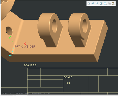

I am a newbie to Creo and I recently created a small format to test it out the scale properties of a drawing.
here I found 2 scale one is drawing sheet scale(!) and view scale? how to call the view scale function in the title block from a format? For this I used &scale.

As far as I know, you can't display a view scale (custom scale) anywhere except in the note that is auto-generated under the view.
I would suggest setting your sheet scale to be the scale of the major view on the sheet and use a custom view scale for any view that isn't that scale.

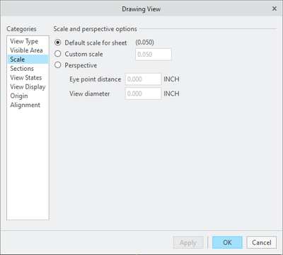

The &scale is the sheet scale.  A view's scale can be adjusted in the view properties to have its own scale and that should generate a label under the view to denote that scale.

If you want them to match, remove the custom scale from the view and change the sheet scale to the desired scale.
