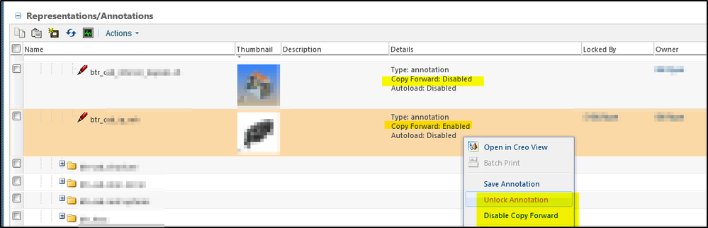

"copy forward" is the functionality you are looking for to bring the annotation forward as the model iterates/revises.   Manually manage it as shown in image below.  I don't know if you can compare a model with markups...

So I have to release It to windchill and that function actually happens through windchill then and not in Creo view itself?
