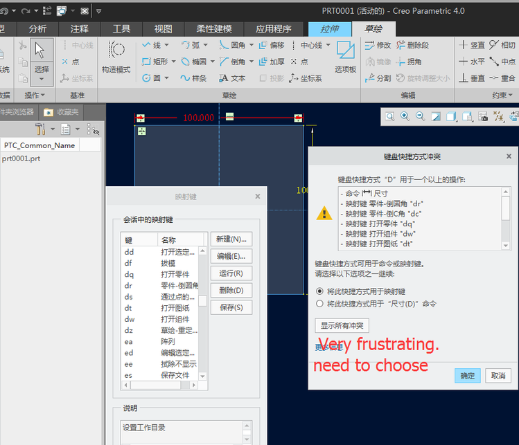

Dear PTC,
Don't use single letter as mapkeys,please.Even since CREO4.0,by default ,a letter is used as a mapkey ,such as,in Parametric ,your use X as the mapkey for Extrude .Because you used "X" and ranked the first ,so I can't use  a combination of X prefixes,for example, "XA" or "XX". When I press down "X" ,creo4 running the "X" program ,not running the "XA" or  "XX" .And ,you can only fitting 26 (from a to z) mapkeys .If you can use 2 letters as mapkeys ,A lot of combinations !
Like me ,I use "cs"  as the mapkey for Extrude ,WHY? C=creat  S=solid , such as ,"rs" r=rotate  s=solid ,"sg"=sketch line ,but I don't use "L" ,because ,L is on the right hand ,thinking ,Wubi input method,G=horizontal ,so ,"g" instead of "L" ;such as "hh"= hide ,"bh"=back hide ,etc. If you need, I will upload me more mapkeys .All on the left hand ,Looking forward to your reply.

Mapkeys are generated by the user (or the company), not PTC. PTC allows you to create single letter mapkeys if you want. It also allows you to create multiple letter mapkeys. If you don't like single letter mapkeys, don't make them as single letter.
TomU
(To:StephenW)
Actually, he's correct.  Creo 4 mapped a bunch of commands to single letters.  If you previously had mapkeys that started with those letters they no longer work.  There is a way to turn these hotkeys off but it has to be done on a user by user basis.  Very frustrating.

epxkle
(To:TomU)
epxkle
(To:TomU)
yes,Very frustrating.
