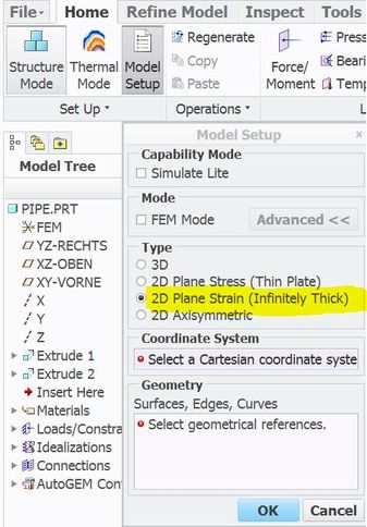

have you suggestion about extrusion?
The simulation have long duration
How I can speed up the process?
The length is 4500 [mm]
Thank you

what is the load?
fstopelli-2
(To:skunks)
Uniformly distributed load over the entire span of simple beam
So, the load is distributed on the entire surface of the beam
skunks
(To:fstopelli-2)
OK, and constraints?
fstopelli-2
(To:skunks)
the ends are not fixed, rotations are allowed (costraint the edge)
skunks
(To:fstopelli-2)
then 2D:

Could you make an analisys example with extrusion of your choice?
Thank you
skunks
(To:fstopelli-2)
att.
