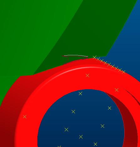

I have the motion law I want to assign to the rotation of the tower in function of the rotation of the cam.

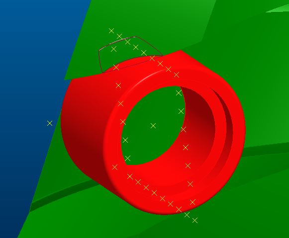

In Mechanism environment, I've made the trace curves of some points of the roller that I've used to cut the cam with surfaces or variable section sweep.
For now, I've tried only one roller cut (three in total).
The cut was decent but there were points where I have interpenetration between cam and roller; especially at the start and the end of the cut.
So I've thinked that I had to rotate the plane of the roller where I've put the points for the trace curves. The situation was better but the motion law I've assigned to the roller was random: a sinusoidal law, as the main one, that at the half reverses the direction (otherwise the cut plane too on itself).
But, which is the right motion law to assign to the cut plane of the roller?
How would you have done?
Would you know tell me where can I find more detailed informations about this kind of 3D modeling?
I searched on the web, but I've not found nothing if not videos like what I've attached where, however, you can't see HOW to do it.
Thanks.

It is very problematic creating features such as this accurately. You can confirm this by patterning the revolved shape of the tool along the path. You will see that often, the profile is different.
This is much the same a gear hob. The helix on the hob are flat yet the result is an involute.
Try creating a centerline spline through the profile. Place a point along that curve. Now pattern that point along that curve. Then set the 1st point to along=0. Create a revolve cut the diameter of the groove width. Use the point pattern to pattern the cut. If all went well, the pattern will follow the normal of the spline which also follows the normal of how it was created.
I have attached an example of why there is a difference.
This is a comparison with the cutting tool patterned through the groove.
You would have to shape your sweep to make sure you fully remove any interfering material in the cam.
Since this is often critical in the machining operation, you would have to specify the tool path and the cutter diameter to ensure conformance. You will require a small amount of clearance from your guide bearing so it can rotate. It is unfortunate that this is not easy to model correctly as it would be machined. I have been fighting this shortcoming for quite some time in Creo.
Typically we can define the requirements but not adequately represent this in CAD. Milling on a cylinder is just not as cut and dry as many believe. What's worse is that often the feature will fail in the way I have defined this due to accuracy issues. And with Creo 2.0 M040 or earlier, patterns like this fail at random intervals. I am fortunate that this one held up as good as it did.

I suspect there is a problem with your measurement analysis for clearance. If you are checking clearance in the same locations as the trace curve, then yes, you will have zero clearance. If you check clearance globally (collision), you will see this before and after the current position. This is what I was trying to show you in the 3rd post.
Along the radial position, this is not an issue. Only along the z-movement (helical movement) of the rollers is where this becomes prevalent. This is easy to check. In the groove, Create an axis between the 1st two trace curves at ratio 0.5. create a plane and revolve cut of what would be your roller bearing profile (including depth). You will find that there is material being cut with this operation, before and after the position of the measurement done with the analysis.
I only say this because in practice, if the part is being machined using a cutter the same diameter as the bearing (with clearance of course), this anomaly would be averted due to the motion of the mill and lathe. But if the is done with a cutter that is smaller with a number of passes, and you are concerned with minimal and consistent clearances, you will have to account for this. If the parts will be processed using a rapid prototype method where conventional tooling is not used, your cam will bind.
Generally, the sweep method and the boundary blends will generate the same profiles. You actually only need two trace curves for the sweep. You can compensate for the issue I raise with making the cut deeper (obviously) and wider to make sure that cut with the patterned cuts is fully cleared. If you want to make sure that your model is 100% accurate, and you want to manage a minimal clearance along the entire path, you have a lot more work to do. With a sweep profile, you can make a variable sweep that follows additional curves. created from known points along the path. These are the points where the patterned revolve cuts removed material.
-Most- of us do not need to be concerned with this as learned craftsman already know about this phenomena. But if you have to analyze a failure or some unexpected anomaly when you build your parts, maybe this discussion will give you some insight as to what might have happened.
I check clearance between parts, and not in the same locations as the trace curve.
In "partial collision detection" check in playback tab, inside mechanism environment, nothing enter into collision.
I attached a pdf file that explains the question.
Also the measure feature checks that there aren't compenetration (as I showed in the video into the ppt file). Naturally, you have to stare that inside mechanism, where it does the verification over all the time.

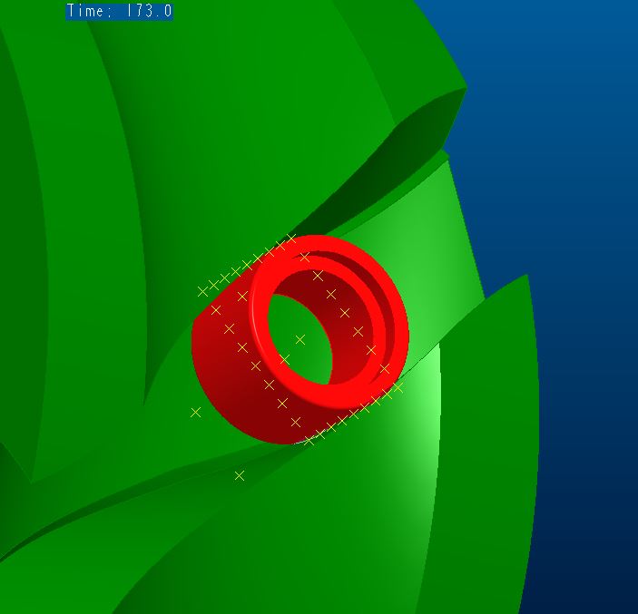

With the envelope generation, I can create a very close surface on the inner and outer faces. The problem is the face that counts; where the bearing rolls. It is an involute face.
I will have a look at your file to see what may be resolving inherent issues. It is sort of amazing that it requires a study to solve what is actually simple in real life. But with rapid prototyping on the rise, our software should be able to "easily" recreate real world machining operations.
Below is what I know is accurate, but "facetted". And with Creo 2 M040, patterns are still buggy.
This has been my long time solution to such problems.
Giulio, thanks for being so persistent with me and providing this file.
I confirmed your findings against the known validation model above.
Indeed, the surface offset method for the walls where the rollers ride creates an accurate roller surface.
The initial sweep based on the two trace curves are all that were required. This appears the only valid sweep as all others seem to deviate due to a twisting action in the trajectory.
I used the offset on the file above and it came out identical (within the graphic limits, obviously).
I then went back to the envelope model I was working with for validation. The offset surfaces from a center sweep did much better than all the sweeps and blends I was able to throw at it.
I also compared the offset to the thicken and when it does not fail, they are also identical. This means that asm0066 above should also be correct (I will review again).
The only difference I found with the envelope model was the bottom of the milling operation. The boundary blend is an approximation. This is no big deal as this is not a functional feature. Just be aware that if milled, it will be somewhat different. I conformed this with a revolve of the mill in the bottom of your cam.
This is the overlay. Very good conformance on the cam surfaces. I could not achieve this with sweeps or boundary blends.
Boundary blend approximation of actual bottom milled surface...
This is the difference with the shaded envelope...
This is the mill shape in the bottom of your cam..
What is nice is that this image shows the tangency between the mill bit cylinder and the offset walls.
