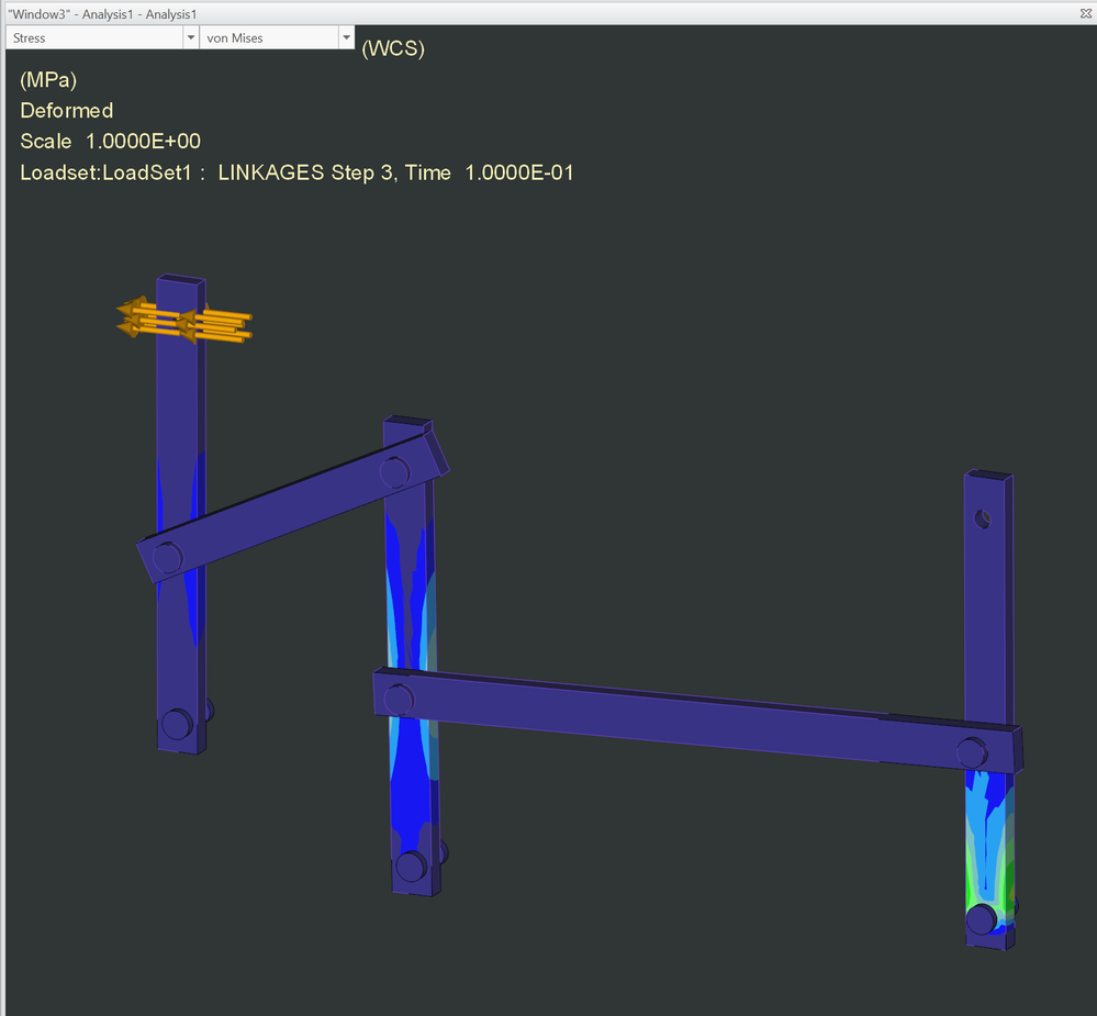

For the purposes of my FEA I am applying the force on the primary lever and holding the pivot of the remote lever fixed so I can see all of the stresses through the linkages. When I run the static analysis, the second linkage disconnects and no forces are transferred to the second linkage or the remote lever. What is really odd is that the intermediate linkage behaves as if it is fixed so it still solves. Also, the stresses are much higher than what I calculated so I don't trust any part of the solution it is giving me.
sort of like this maybe? Model
Stress

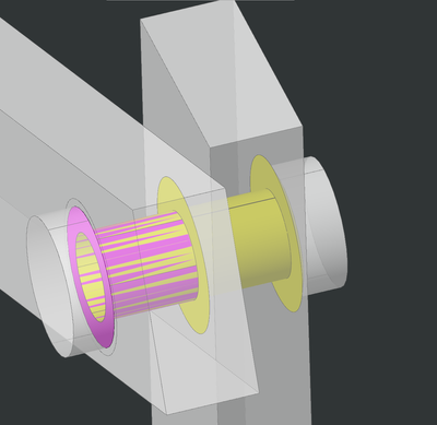

Pin model interfaces
Is it possible your pins or links are under-constrained and free in axial translation? My pin is bonded to one of the link elements and the 2nd link element is sandwiched by contacts to arrest translation, in addition to the cylindrical contact. I made disc shaped surface regions at all the pins to accomplish this.
Are there bending stresses at the bottom of your 2nd lever, more like the remote lever in my result? This would mean it is somehow not free to rotate.

You have the right idea on the linkage arrangement. The main difference is the linkages have clevis that fits around the lever. The pin is bonded to the clevis and the lever has a contact between the pin as well as one on each face of the clevis so it should be constrained from axial movement.
My results show stresses similar to what you have on the primary and intermediate levers, but the 2nd linkage and remote lever are completely cold with no stress.

The intermediate lever has an offset bend and the hole for the pin is created using a sheet metal extrude with the default options. When you do this, Creo generates two half cylinder surfaces instead of one continuous cylindrical surface. When the surface is split in half, it is very easy to create a contact interface to only half of the hole surface leaving it free to separate in the opposite direction.
The simple fix is to change the extrude to use the perpendicular to surface option and make sure that the contact interface includes the entire cylindrical surface. When this is done, it solves as expected.
