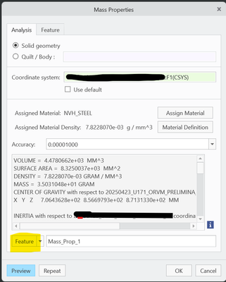

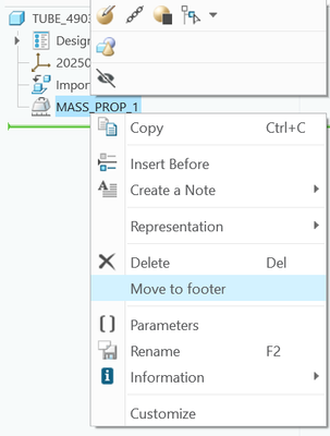

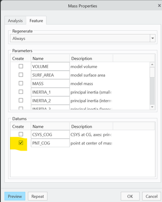

Note on the separate issue of automatic cog point. (for some other workflows.)
  • To streamline use a Parametric license with behavioral modelling that allows automatic creation of point or csy at cog. This will automatically update to the value at where the measure feature is in the model tree. Moving to the footer is the most common situation but in a rare case you might want to take the mass before some additional features are added.
  • if you really want the component at point to follow exactly at the cog, even though that is not necessary...
    • In another simplified rep or the master rep with the component included, make a point at the assembly level that is ON the cog point (from the analysis feature) in the part . This creates a relationship that will update when regenerating, but only if the referenced component is included at the time of regeneration. This means some switching between reps to do an update, but then this new point can be referenced even when the part is excluded because it is in a part or assembly that is not excluded.

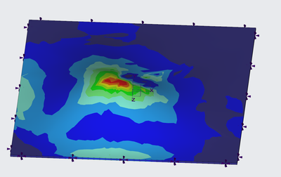

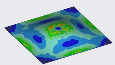

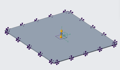

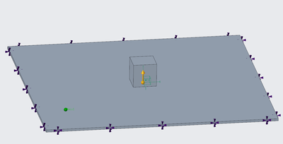

Hmm this does not match my testing - here is a point off the centroid of the part to be replaced (node is rigidly linked to center of plate):
And here is the same thing but with the mass / centroid at the center of the plate:
This to me says that the location of the point chosen does matter.
This is a pretty extreme case of being off from the correct point. Also the mass is not attached in your examples. It is not connected to an element. Rigids do not count as elements. Also, why is the rigid connection showing in the second and not the first image?
  • This is a pretty extreme case of being off from the correct point.
    • Chose an extreme case to test
  • Also the mass is not attached in your examples. It is not connected to an element. Rigids do not count as elements.
    • Do you have a suggested alternate attachment for the point mass?
  • Also, why is the rigid connection showing in the second and not the first image?
    • Just had different things blanked / included for the screenshot to show the test part. The cube is the part which is being replaced but the assigned mass. It is connected in the same way to the same surface as in the second image, only the original location of the adpt is changed.
