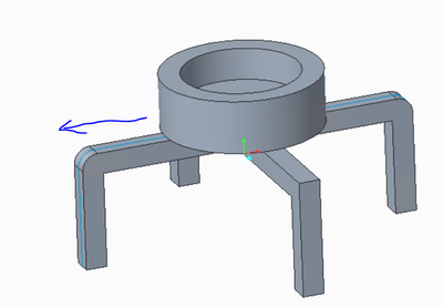

I want to analyze he effect of gravity on the pot placed on stand.
When we placed the pot towards the end of stand due to the gravity it should fall down.
Can we create this situation in creo & see?

Maybe I'm looking at it too simply, but don't you just need to have Creo calculate the center of gravity of your assembly of the pot and legs? If the gravity force vector is outside the legs, it tips over. Isn't that all you need, or is there some other force(s) involved?

Thanks for the reply. Actually I am looking for animated video of this gravity effect. So that I can see & measure few of the parameters from it.

If you do not matter  I would suggest to use friction less contact between both parts and displace the upper part laterally until the CG is out of the base. At this point the gravity will make the part to tilt.
You can use a prescribed lateral displacement with sub steps to create a nice video.
You can move a point attached to the upper structure with gravity direction RX RY free and all other DOF fixed (you may need some constrain adjustments here is you find some simulations error).
So you will see when the first tilt occurs meaning that from this point one the fall will start.
The hole point is to limit the amount of movement between steps otherwise you will have convergence problems.
I would create a shift enough to see the initial tilt. Otherwise the simulation may take too long. Also do not put this auxiliar point in the CG of the part - put it outside. So you can see the tilt starting (what it will nit happen if you hold the part on its CG).

I played a bit with the model last week but I don´t know why, it does not rotate when it leaves the base.
Actually, there are more strange behavior going on the model - as for example a huge displacement even using a fix input displacement.
I´ll send you the model this week but I am afraid you have to play a bit with it alone - I cannot systematically try to figure out what Simulate is doing. It can be that it does not work using linear analysis, no idea.
Another suggestion to test the rotation is to pre-assembly the upper part already near the point that the CG is out of the base - this avoids the huge displacement necessary that the CG of the upper part leaves the base.

Anyway, here is the model with contact.
Unfortunately the idea does not work – there is no rotation of the part as the Center of Gravity (CG) leaves the base – at this point the part should start to tilt – I´m not sure why there is no tilt and some control measurements are reporting strange numbers.
The springs are used to stabilize the model ad do not create high displacements with very little force. They are also used to shift the model out of the base.
There is no gravity but simply a force in the CG of the part. If you know the weight you can update the force. I used 1N because I have defined springs with low axial and angular stiffness.
You can try to check the  large deformation analysis box – but it will take a long time and I am almost sure that the simulation will not converge – Apart of this I don´t know what else can be used to create rotation of the part when the CG is out of the base.
One problem in this model is that if the model tilts the contact will be virtually 2 points in the edge. I don´t think Creo can handle this.
A more defined tilt would be to use the long side of the base. In tis case you have to define another contact in one of the rounds at the end of one of the legs of the base.
You will need a new assembly but everything else can be used in the simulation.
Good luck – and maybe someone else comes with another idea.
