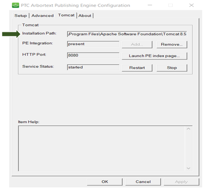

Arbortext Publishing Engine does not Identify Apache Tomcat from the system even it is successfully installed
Answer

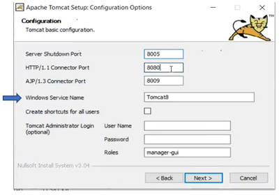

  1. Installation Path will be blanked but Tomcat is already installed in the systemM_Milutinovic_3-1682533108256.png
  2. At the time of installing Tomcat keep the Windows Service name as Tomcat8 because by default, the Windows service is named is named Tomcatn, where n is the major release number of Tomcat (for example, Tomcat8.5). Do not rename the Tomcat service because the Arbortext Publishing Engine Configuration utility will not be able to find it. Having a different name prevents the ability of Arbortext Publishing Engine Configuration to start and stop the service. For more details please refer the help center topic Installing Tomcat
