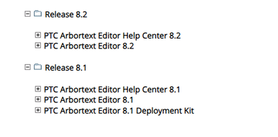

Hi together,
from the Arbortext Editor i can only find a deployment kit version of 8.1.
Is it planned to publish a deployment kit version of 8.2. in the near future? So we could use this version.

Hi Hubert,
PTC removed support for the Compact Installer (deployment kit) in 8.1.2.0.
Please review the following Article:
Missing Deployment Kit for PTC Arbortext Editor 8.2

Hi Alexia,
thanks for your fast reply. We didnt know that. In our company we are using the Arbortext Editor compact installer and update our customizations with a custom.zip. This is/was very comfortable.
Do you know an alternative way? I think if the compact installer is no more supported, there must be an alternative, because we cannot update all the user PCs if we have changes in our customizations.

Hopefully the Help center topic Deploying zipped customisations will help you find a way that works well for you.
Go to Help > Help Center and search for the topic Deploying zipped customisations

Thank you Alexia, that was very helpful.
