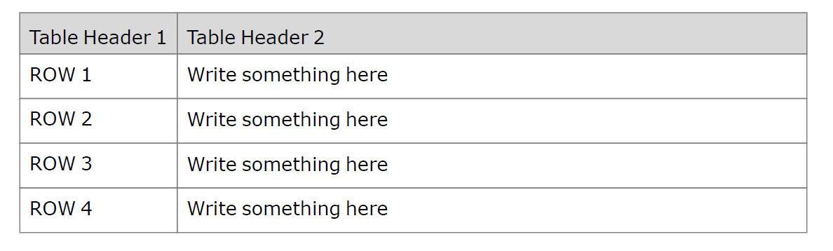

I am currently working on a process which publish an xml to PDF. I use APP. I would like to have a table which borders are gray and header row is with gray background. Like in this figure:

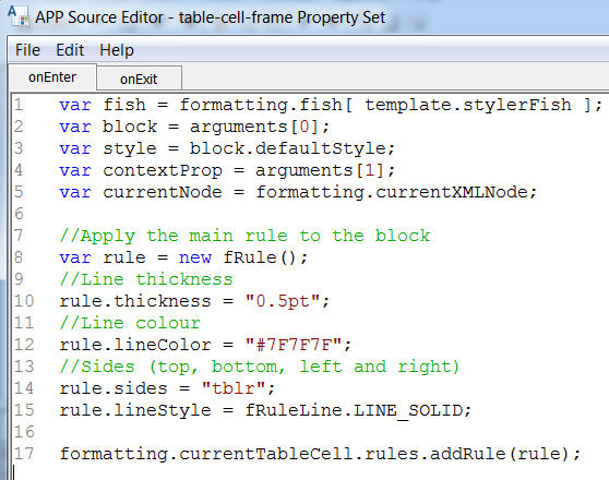

However, when I do the same for table cell border, it goes into problem. Here are what I do:
1. I create a Property set "table-cell-frame" which create a rule, and then I add that rule into current table cell. Like this:
2. I added that property to context "entry anywhere in thead"
The output, in fact, is working as desired. However, there are errors in event log. The errors are:
"Pg 4 JavaScript: Error: Error: fRules.addRule: Invalid object addRule([object fRule])@:0 onEnter([object Object],[object Object])@stylesheet0:PropertySet:table-cell-frame:onEnter:24
onEnter([object fStreamPos])@stylesheet0:Element:entry:theadentry7936:onEnter:23 runMacro("sprint \"_app:spFormatWithIndex\"",true)@:0 @_app:FormatWithIndex:3
. [1500]  (2:"stylesheet0:Element:entry:theadentry7936:onEnter"#93) (1:"editorDom0"#{0;/RDStyle/ResolvedMap/techinfomap/division[1]/concept/conbody/table/tgroup/thead/row/entry[1]/p}) "

Thank Chris! Even though the table layout is correct, I was not happy with all the errors in EventLog, it doesn't look nice.
Finally, one of my colleague found out what is wrong:
- It seems a rule created by new fRule doesn't create an object that the formatting want to be using
- addRule() documentation shows that the function can be used to return an object as well, so a rule object is created by addRule()
- No need to add it again later
So the solution is:
And no error appears. 🙂
